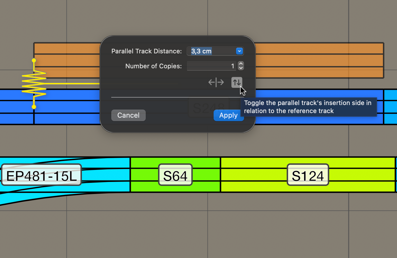

I may be using the parallel assistant incorrectly -- that is extremely likely.
But when I have a curved pieced of track on the layout -- say a Kato Unitrack 2-220 with a radius of 610 mm -- and then select a piece of curved track with a smaller radius -- say a Kato Unitrack 2-210 with a radius of 550 mm -- to be added as parallel, the new track gets added on the outside if the current track.
What I am trying to do is build an HO T-Trak corner module -- 90°of a 610 mm curve -- and 90° of a 550 mm curve inside of that -- two concentric ¼ circles.
Is there a way to specify on which side of the existing track I want the new track to be added?
Posts: 614
Re: Trying to set 60 mm track spacing -- HO T-Trak Standard
mikepwagner wrote: 03 Dec 2025, 15:08 Is there a way to specify on which side of the existing track I want the new track to be added?
Absolutely, that's the function of the buttons in the dialog:

RailModeller Support wrote: 04 Dec 2025, 07:21
Exactly what I was looking for — thanks.
