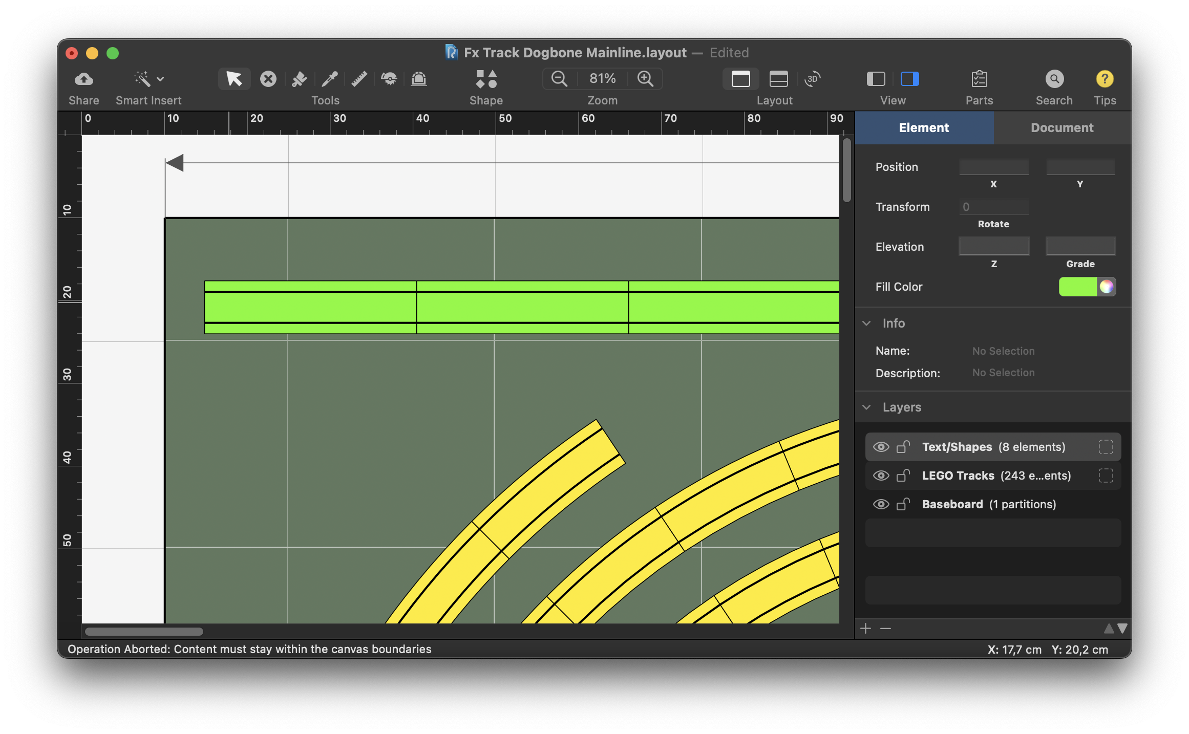

..first thing you could always check:
If you've configured RailModeller Pro on your Mac to use the Fixed mode for the canvas (see The Drawing Canvas section in the app's User Guide) it has to reject any content exceeding the canvas size you've specified for the particular layout in the Document settings in the sidebar.
The app will show an appropriate message in the status bar at the bottom of the window that case

Re: Cannot move track or other objects with the mouse
Ian,
I'm having the same problem. I have Version 6.5.4 (Build 1583) running on MacOS Sequoia 15.3.1 (24D70). My Canvas Size Mode is set to Auto-Resizing.
Jeff
Jeff
Jeff,
can you describe the type of layer, tool used and the steps to replicate so I can investigate?
