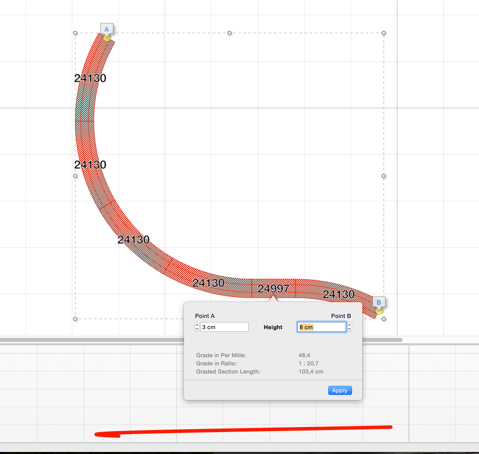

I also encountered some strange things when adjusting the levels. When I selected a number of tracks (2-5) that was at the end (they always included a Märklin 24997) and wanted to adjust the height I got the Height dialogue box but no matter what I changed the values to it didn't work. When I selected the tracks one by one it worked. Already in the dialogue the numbers entered correctly but I couldn't preview the change.

I've just performed a few tests with grading multiple tracks including the 24997 track but it worked as expected..
Does the height/grade change while editing the values when you're in the 2.5D view with the height profile view at the bottom enabled (middle setting in the Layout toolbar control)?
