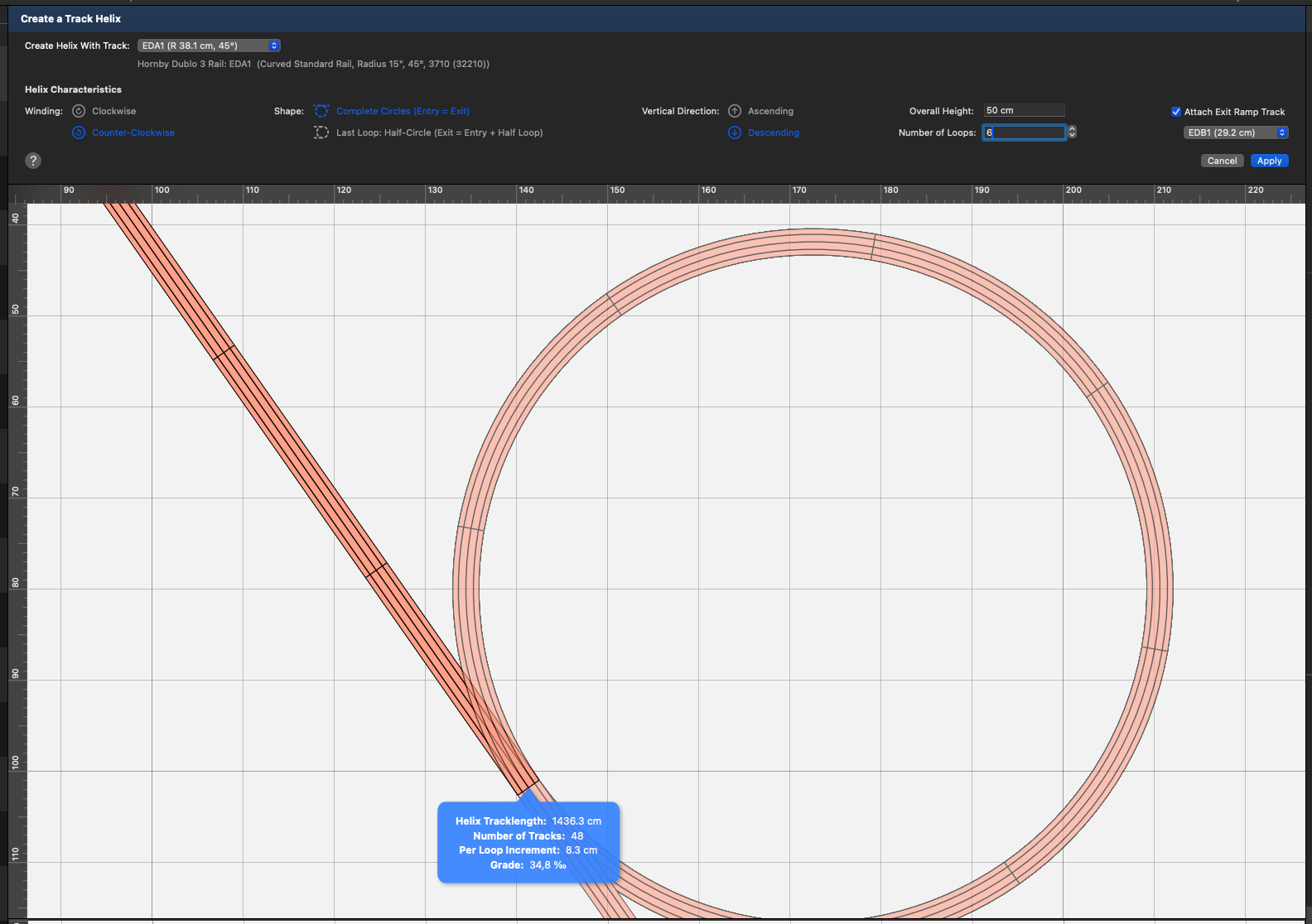

Re: Edit a Helix created with Smart Insert
Hi André,
The Helix Assistant helps you add the sequence of tracks that forms a helix to your layout. Once placed, these become regular track sections that you can edit just like any other tracks in your layout. That is you can:
  • Modify individual tracks of the helix as needed, or
  • Delete the entire helix (e.g. using Undo) and use the Helix Assistant again with different parameters
As you work in the Helix Assistant, its preview window also shows detailed information for the resulting helix based on your parameters before inserting the track helix into your layout.
