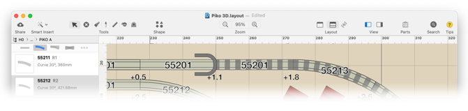

The toolbar at the top of every document provides access to global tools and settings like
  • The Smart Insert tools
  • Module specific tools
  • The Shapes pop-up menu
  • The Layout Controls
  • The View Controls
  • The Part List
  • The Search control
The Smart Insert pop-up menu in the toolbar provides assistants that support you when inserting new tracks into the layout.
The following assistants are currently available:
  • Parallel Track
  • Create Track Helix
  • Connect with Flex Track
  • Close Gap with Tracks
Two tracks in the layout can be connected with an automatically calculated piece of flex track using the Connect with Flex Track function.
A gap between two tracks can be closed with one or multiple pieces of sectional track using the Close Gap with Tracks function.
The sections Smart Insert: Connect with Flex Track and Smart Insert: Close Gap with Tracks in the user guide also provide additional details.
