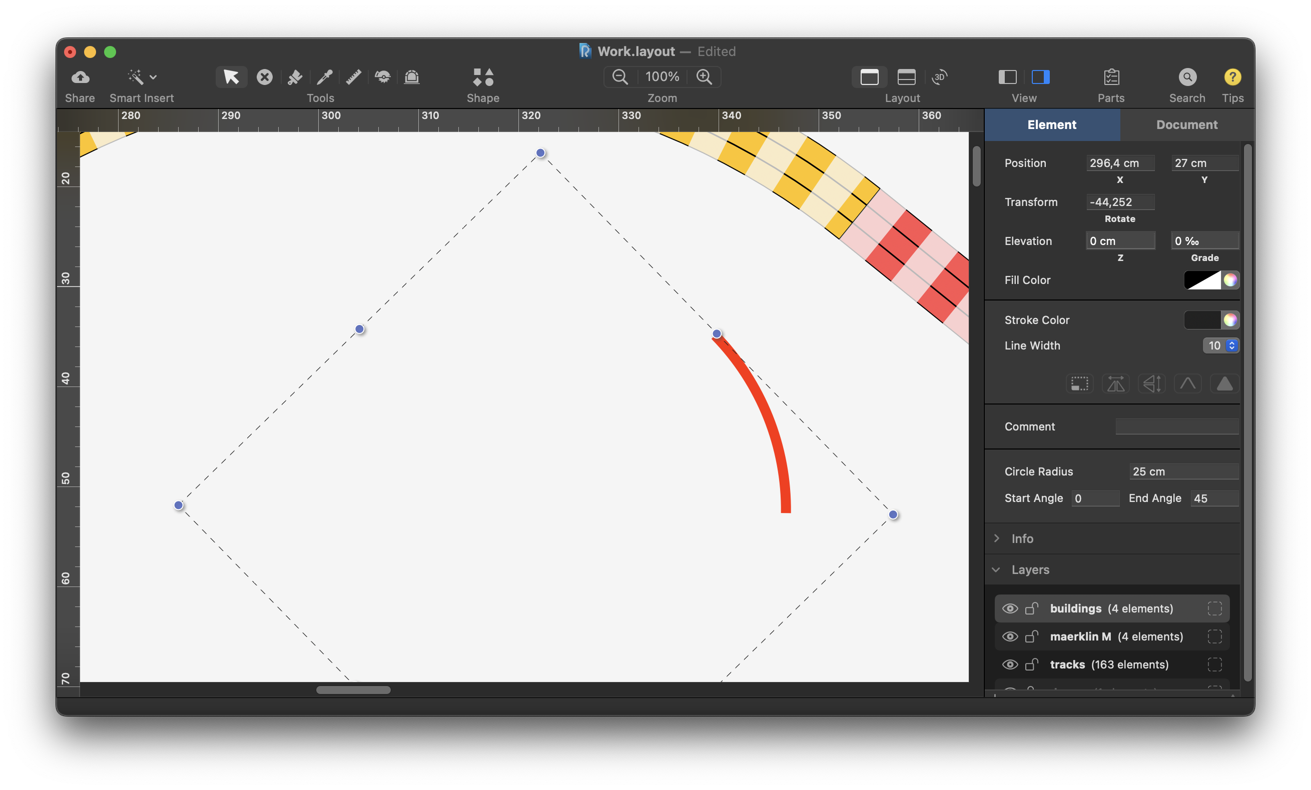

I want to draw a curved platform onto my plan. How do I go about doing this?
Re: Curved shapes
Hello Rob,
one option would be a circle shape from the Shape pop-up menu in the toolbar and configure it to show only a circle segment:
Screenshot 2023-12-13 at 18.53.17.png (899.38 KiB) Viewed 8526 times
Another option would be just a poly shape with enough points to resemble the desired platform shape.

Thanks.
The circle option is difficult to use as I currently have a curved piece of track with a curve radius of 500cm and an arc angle of 10. A 10 degree circle that large affects the size of the document as it creates a bounding square.
I'll live with a polygon, and live with having to re-do all the polygon points when I change the arc angle of the track..
