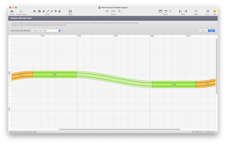

The flex connect function looks at both tracks to be joined;
If the tracks are mostly parallel (and a connection is possible) they're connected with an ess curve (flex with 4 control points)
Flex connect parallel.jpg (78.4 KiB) Viewed 4990 times

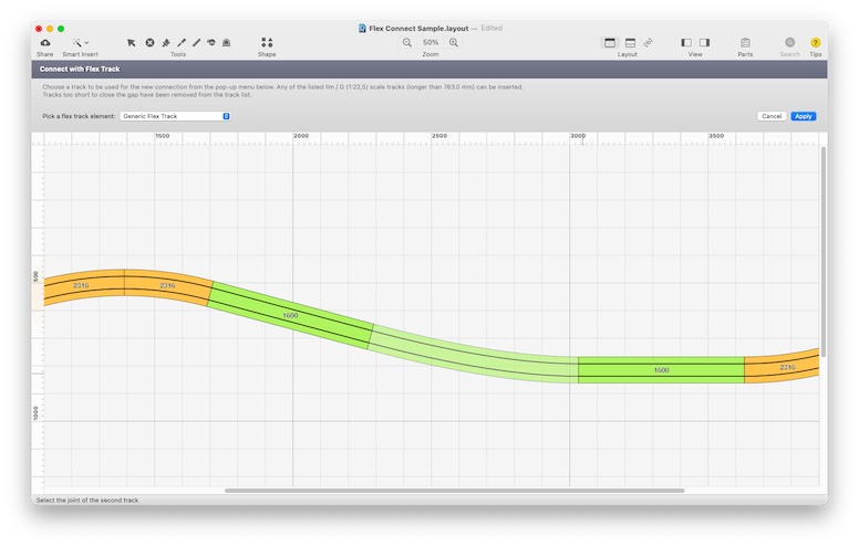

If the tracks can be joined with some curved shape - the imagined extensions of each track cross each other - then a curved track is created (flex with 3 control points)
Flex connect simple.jpg (80.24 KiB) Viewed 4990 times
RailModeller Pro uses bezier curves internally to allow freely bent flex tracks, not just a series of curves.
