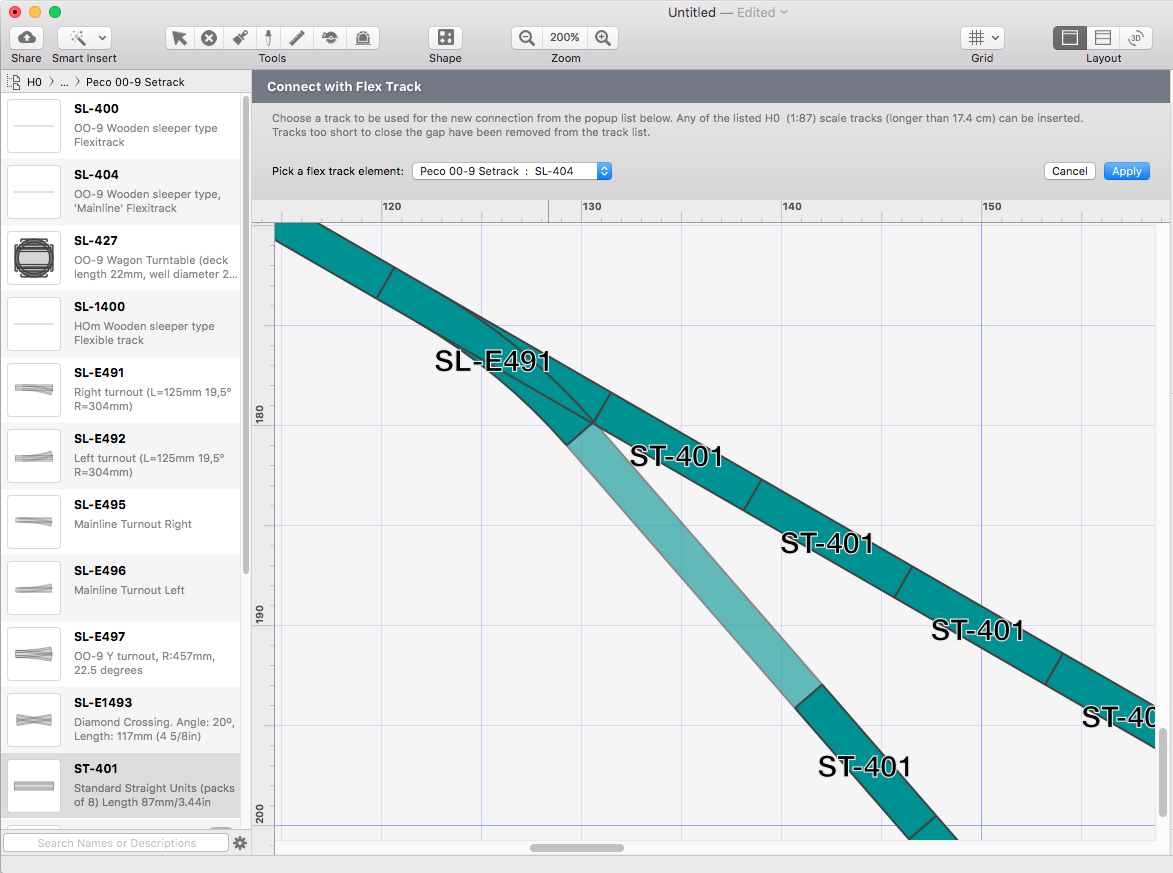

However you can’t connect them using “smart insert > flexitrack” to other 009 setrack pieces as it says they are a different gauge.
When I use “smart insert > flexitrack” just between these points it will only let you use generic flexitrack or HOe flexitrack.
It looks like they are still marked as HOe track not 009 even though they are now in the 009 library.
Hope that makes sense and a fix can be made at the next update.
Andy
Peco 00-9 library update
Hi Andy,
please note that tracks already in the layout will not be updated automatically by the app. This is to avoid potentially unwanted changes to existing layouts without the author's consent.
So the turnouts inserted into your layout from the old Peco H0e library will still be tagged as tracks with H0e model scale while newly inserted turnouts from the 00-9 library will work with the Connect with Flex (and other) functions.
Connect Flex.png (240.11 KiB) Viewed 9017 times

Thank you Jan.
I just presumed the new points would be updated.
Deleted and replaced them and all works as you say.
Excellent support
