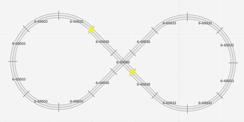

SHouldn't this basic layout line up? It isn't.
- Screen Shot 2015-10-17 at 9.32.05 AM.png (60.81 KiB) Viewed 4388 times
Regards … ErnestHouse

Hi Ernest,
I'll have a look at the Lionel O27 track library - the radius of the O27 curved track seems a bit off.
