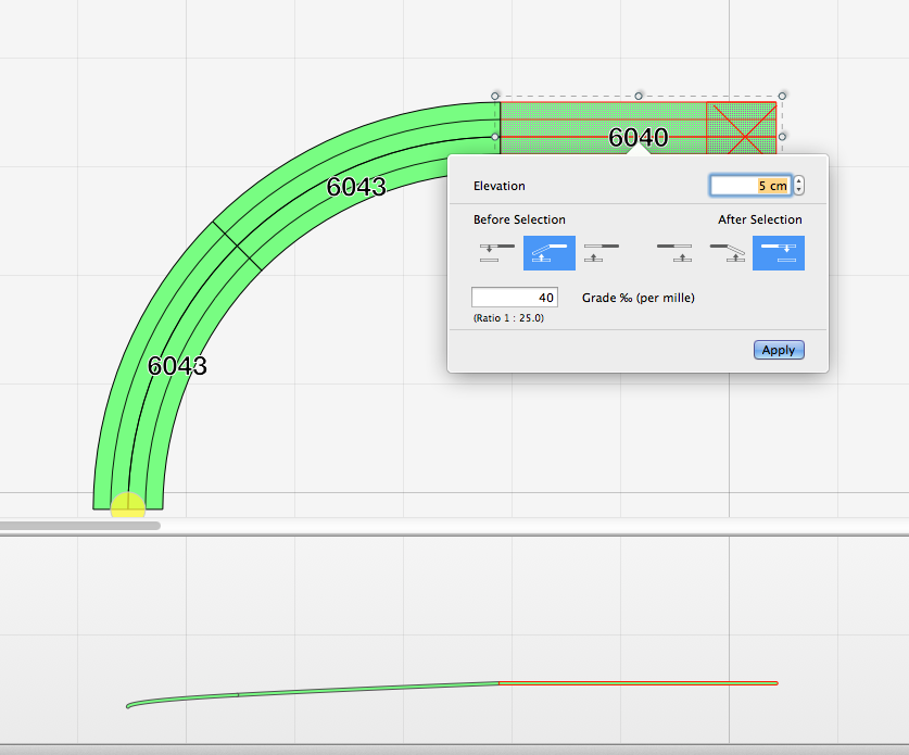

this is indeed a bug when setting grades for a track section including a bumper track. I've fixed the issue for the next update.
As a work around you could either deselect just the bumper track using Shift-Click, then set the grade for the section of tracks excluding the bumper track and finally re-appending the track by disconnecting and re-connecting it using the mouse.
You can optionally just select bumper track and create a graded section to the track by specifying a value for the grade in order to control how many tracks should be graded.
Screen Shot 2015-10-07 at 4.49.20 PM.png (83.9 KiB) Viewed 5837 times
