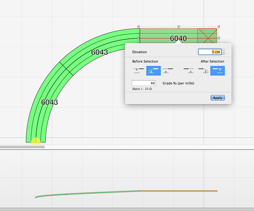

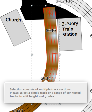

Using 5.0.11. Whenever I use the Atlas 21st Century track piece 6040 10" bumper, I can't set the grade. Get an error "Selection consists of multiple sections of track..."
- Screen Shot 2015-10-06 at 10.50.35 AM.png (64.44 KiB) Viewed 5963 times

Hi Ernest,
this is indeed a bug when setting grades for a track section including a bumper track. I've fixed the issue for the next update.
As a work around you could either deselect just the bumper track using Shift-Click, then set the grade for the section of tracks excluding the bumper track and finally re-appending the track by disconnecting and re-connecting it using the mouse.
You can optionally just select bumper track and create a graded section to the track by specifying a value for the grade in order to control how many tracks should be graded.

Yes. That's what I've been doing. Will catch the fix on the next version. Thanks.
