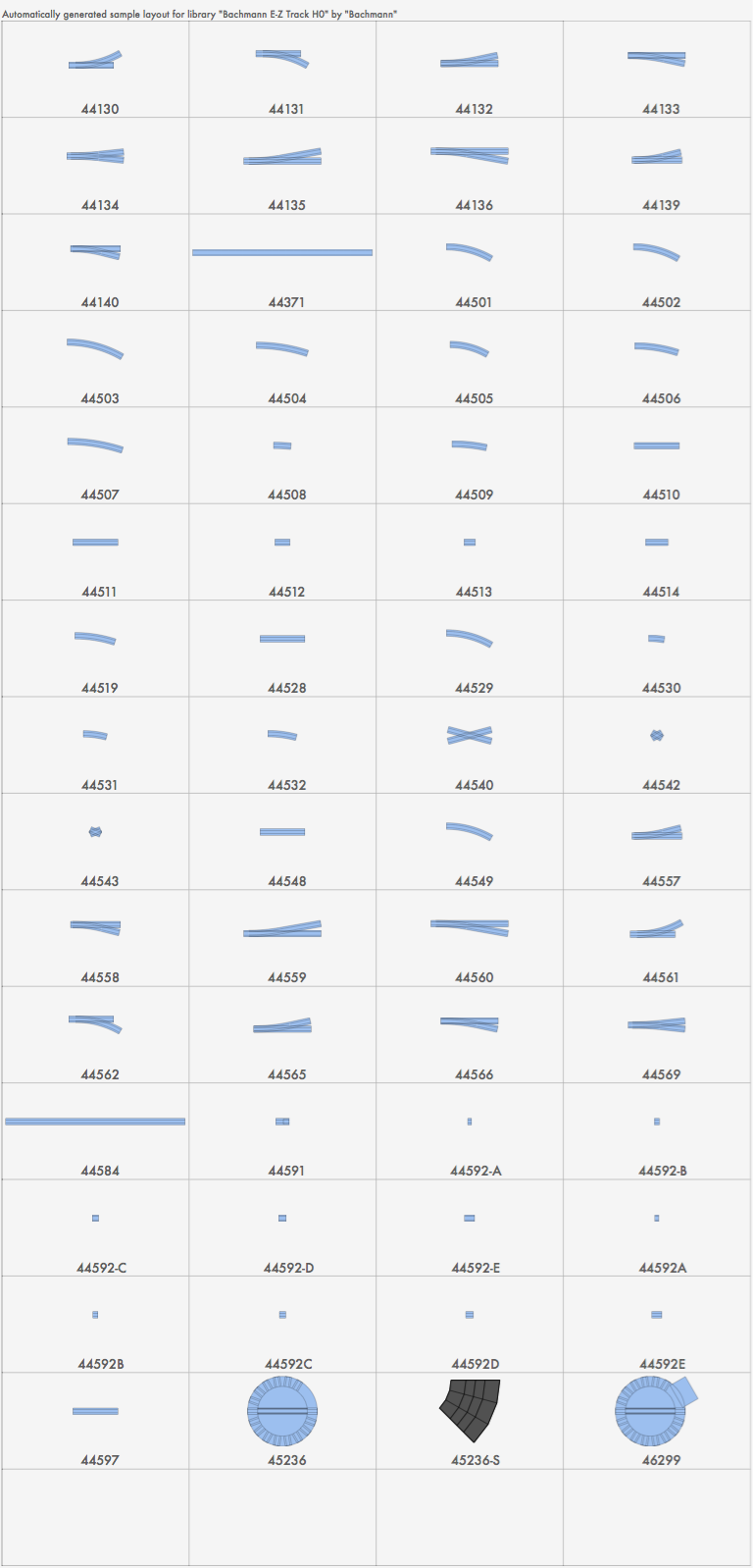

sorry for the delay! The Bachmann EZ Track library has been thoroughly updated for our upcoming 5.1 release.
You can download a preview of the library here (import via File > Track Libraries > Import):
http://www.railmodeller.com/files/downl ... rackH0.zip
Update - As of today's (May 21) public release of update 5.1 the complete E-Z track library is now available as part of the regular app!

- Bachmann EZ H0.png (179.7 KiB) Viewed 8206 times
