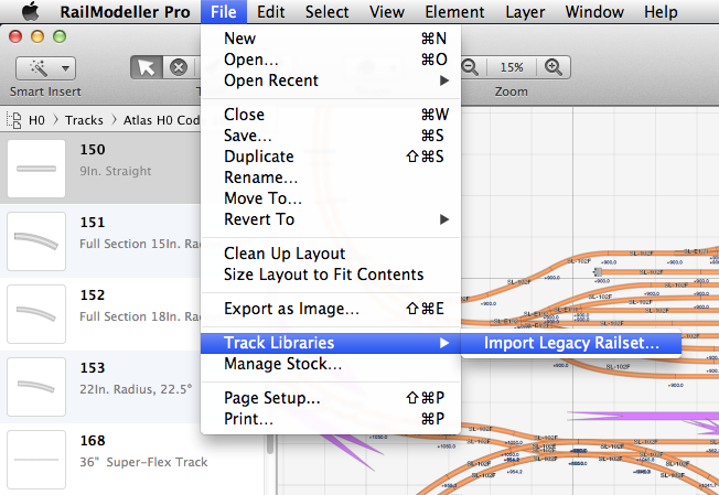

Quick follow-up:
Old style railsets can be imported with recent versions of the app using File > Track Libraries > Import Legacy Railset.
