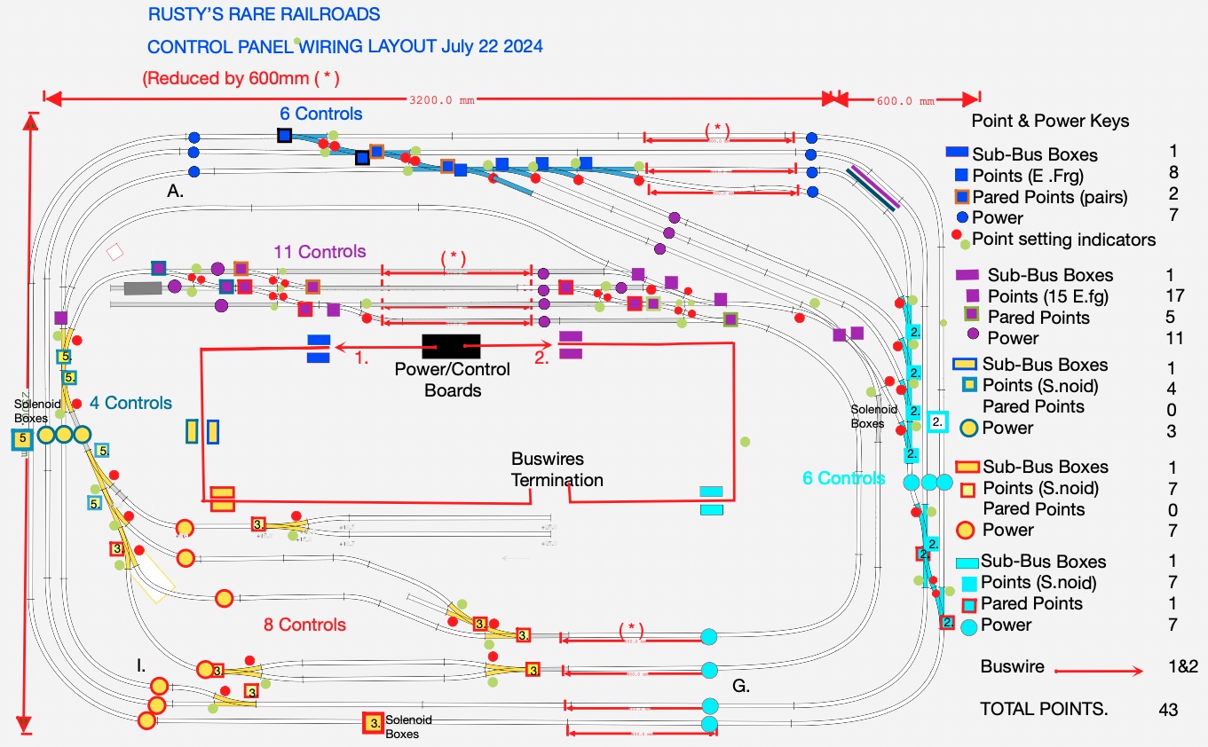

Plagiarising Lenny Henry's excellent radio comedy programme "Rudie's Rare Records", I decided to call my new project, "RUSTY'S RARE RAILROADS". This is in memory of my fourteen year old Border Terrier who died two years ago, leaving me with such fond memories..
Having filled my time during lock down by building a Hornby Settrack railway, I have now progressed to Peco InsulFrog points, and am planning an expanded installation with forty three points in all. Easy? Not likely: 'InsulFrog' opened up the whole new problem of track power. The accompanying diagram is the latest iteration of my plan, and hopefully I will start work on track laying early next week.
I've gone cross eyed over droppers and tracks with no power supply, but here goes.
