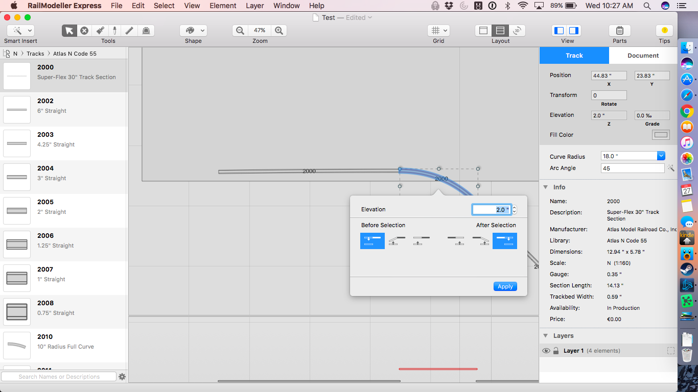

Below is a screeenshot of how I'm trying to do this. So far, all Ive managed to do is elevate the middle section 4" off the baseboard. :)

Re: A few newbie questions
Brammy wrote:Thanks. I'm still confused though.
No worries - Maybe this post (going into details with grading tracks) helps:
viewtopic.php?f=4&t=59#p4385
We've also created a tutorial on this topic:
https://www.youtube.com/watch?v=LtEhHiA-Pqs
Brammy wrote:Also, in relation to flex track, how can I have a mostly straight section of flex with a little jog near the end?
Flex tracks can be freely bent by double-clicking the track (or using the Element > Edit menu command) and then moving the handles.
