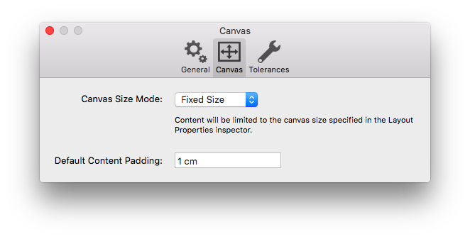

the latest update now finally adds a preferences option to turn off the auto-resizing behavior if desired:
The Canvas tab now offers a Canvas Size Mode setting with two modes
  • Fixed Size always keeps the document at the size specified in the Document tab in the side bar,
  • Auto-Resizing will adapt the document size by extending it automatically when required.
