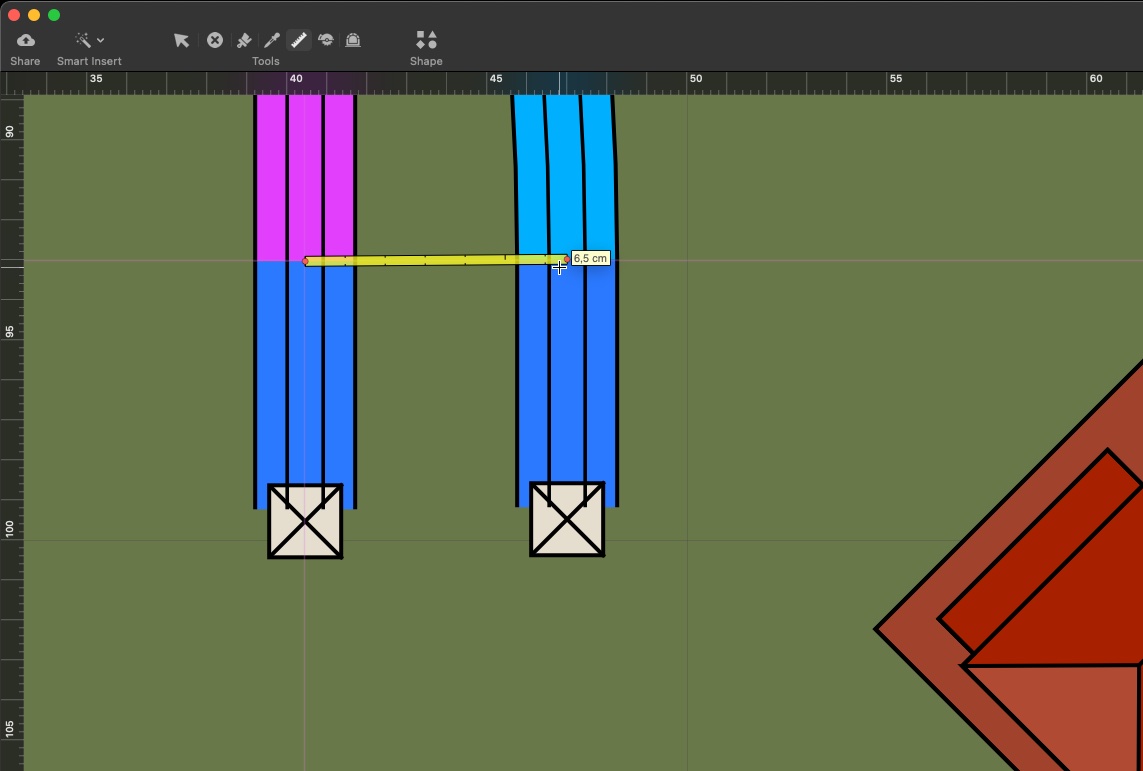

You can use the Measure tool available when editing a layer containing tracks, accessories or shapes:
The Measure tool provides a tape measure for measuring distances in the layout.
It also snaps to joints of tracks or baseboard corner points and can be restricted to a multiple of a 45-degree angle while holding down Shift.
