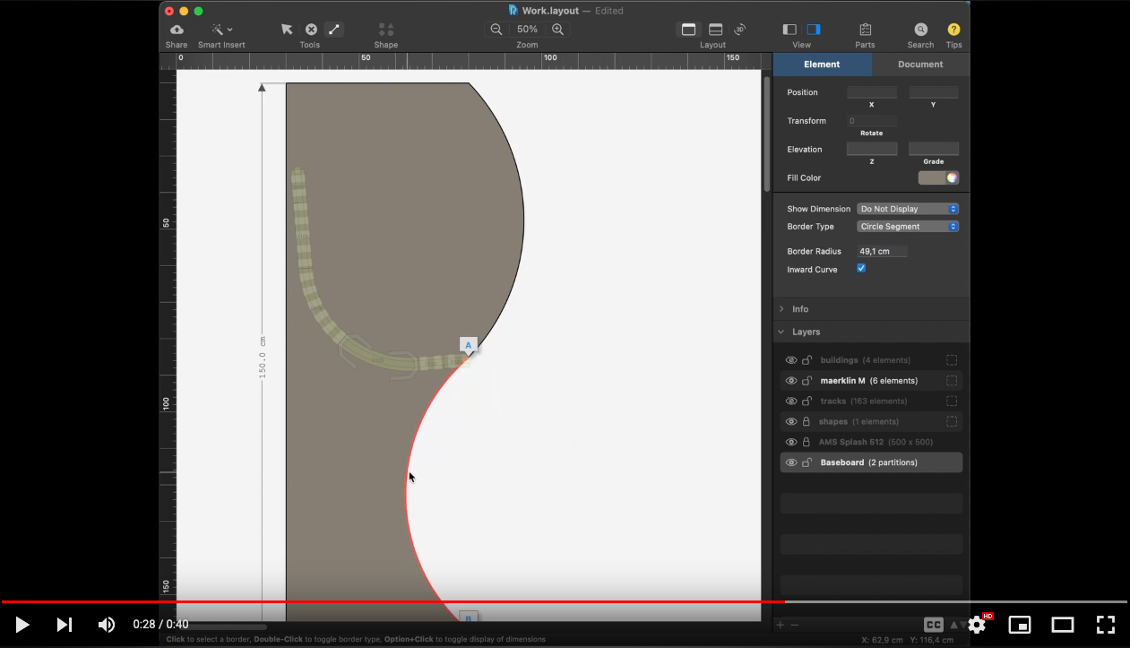

A completely reworked mechanism for editing curved baseboard borders is in the works and scheduled for an upcoming maintenance update!
thanks,
Re: Curved Baseboards
Thanks again for the feedback -
The reworked inspector and baseboard border tool will be available in the upcoming 6.4.23 maintenance.
Curved baseboard borders can now (soon) be edited by just dragging the border with the mouse:
RailModeller Pro 6.4.23 - Improved circular border segments.png (175.19 KiB) Viewed 13794 times
https://youtu.be/wd-nT3WuDcw
The latest update to version 6.4.23 is now available featuring improved baseboard functionality:
  • The Baseboard Assistant features a new triangle template and has improved usability and visuals
  • Arc Baseboard Borders have been reworked for easy border radius editing through dragging and a simplified inspector
  • The Baseboard Border inspector has been simplified, now labeling both border points in the layout for easy reference
