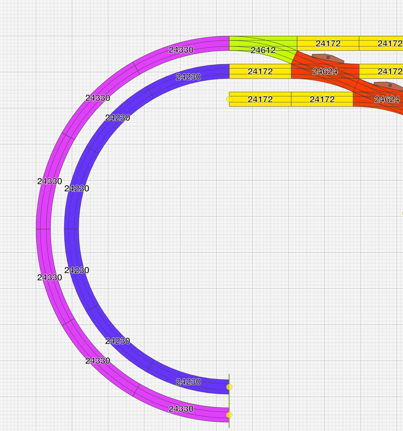

I first noticed the problem using two concentric curves with R2 24230 and R3 24330. The R3 was "short" compared to the R2 and on a 90 degree or 180 degree curve the end of the curved tracks would not be aligned. I looked at the elements to see if maybe the lengths were incorrect but they seemed just about right. But on the layout there clearly was an issue.
I then also noticed that using the the turnouts, 24611 or 24612, to set the 77.5mm track spacing there was something wrong there as well. Using 2 attached turnouts to set the appropriate spacing the straight tracks on either side of the turnouts were not parallel- in my case going in one direction spacing was widening the further from the turnouts the straight tracks were laid down. I only noticed this with longer straights using 6 or 7 straight tracks.
And this is what I think explains why the R2 and R3 curves do not align properly. The issue is that on a larger layouts these discrepancies compound and make it difficult to determine what track and how much of it is required when making adjustments if one strays from the perfect c track geometry- in other words you cannot tell how much is due to the software's incorrect geometry and how much is really the adjustment needed when laying down the actual track and what track lengths are effectively needed.

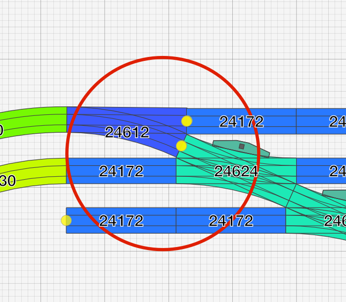

Thanks for sending the layout over.
So as you can see tracks are not connected at the encircled location but shifted by a couple millimeters.
This misalignment propagates to various parts of the layout.
misaligned tracks.png (125.48 KiB) Viewed 3244 times
When reconnecting these tracks the parallel circle is also nicely aligned at the proper Märklin C parallel track distance of 77.5mm.

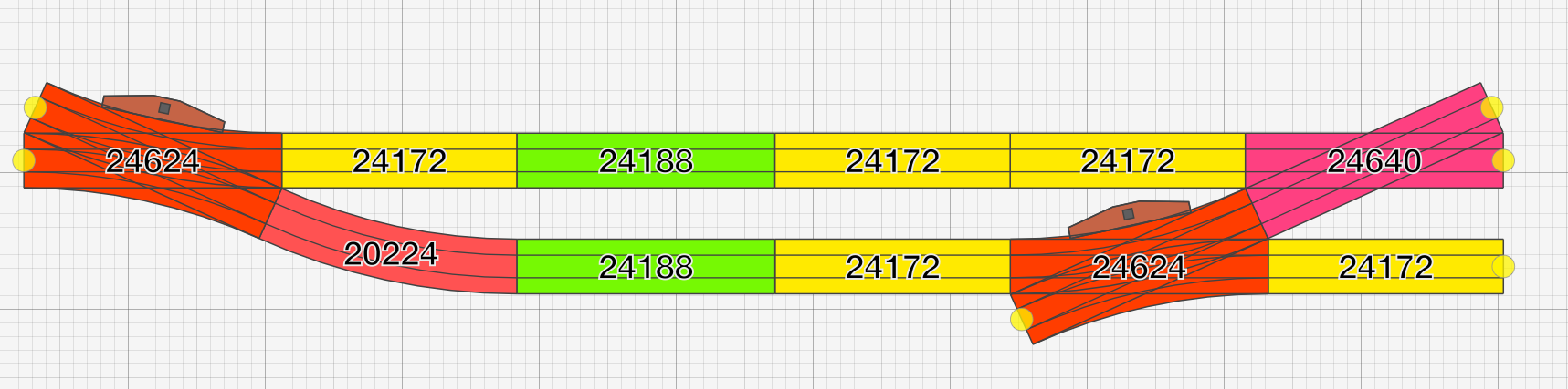

Same for the combination of crossing and 20224 curved track, though this is a somewhat special setup:
The way Marklin designed the C track system the 24624 double-slip turnout is a multi-purpose track that can be used in various situations.
To make all of them mostly work the track isn't a perfect replacement for the curved track but just a close match.
In general you will occasionally notice small mismatches when planning model train layouts on the computer, in particular when sectional tracks are used exclusively and no flex tracks are available.

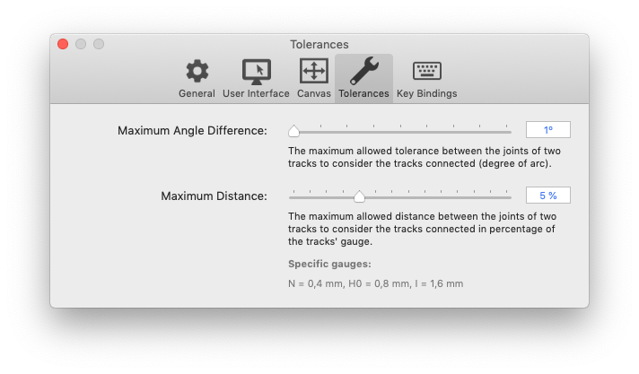

You can use the tolerance settings in the app's preferences to relax the precision requirement for connections to be recognized, or insert tiny pieces of flex track or shortened sectional tracks if desired to close tiny gaps.
