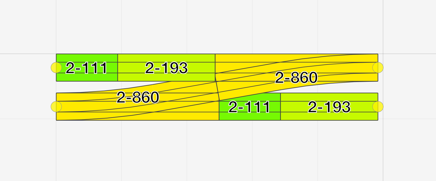

Got it!
So according to https://www.1999.co.jp/eng/10147590 the Unitrack HV4 set (#3-114) includes
  • No. 6 electric points (left) × 2,
  • S94 × 2 auxiliary straight line,
  • S149 × 2 straight lines
I've recreated the set in RailModeller Pro according to this description and it looks good:
HV4 in RailModeller with individual tracks
Screenshot 2020-09-21 at 07.39.28.png (103.54 KiB) Viewed 4956 times
Kato Unitrack HV4
Kato Unitrack HV4
