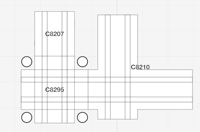

I have a big issue with C8295 Elevated Cross Over.
That item doesn't work correctly with RailModeller Pro.
It is not possible to use it to build Scalextric layout.
See attached 'Scalextric layout' example with that issue.
¿Has anybody that isuue too?

Same here, with the two half-straights it is supposed to be a match for the C8210 crossover, but the latter matches up in RailModeller, while the former does not.
Re: SCALEXTRIC | Big issue with C8295 Elevated Cross Over
Posted: 18 Jan 2020, 22:42
by david oxford
The dimensions they have for the C8295 match don't match the flat crossover, but do match the description on the Scalextric site:
I did wonder the C8295 straights are a little longer to allow for the approach ramps being sloped (and thus a little shorted if viewed from above), but then the lower deck also seems to be different in length.
I don't have one to measure it out or try it. I'd get one or two if I was more confident they'd fit.
