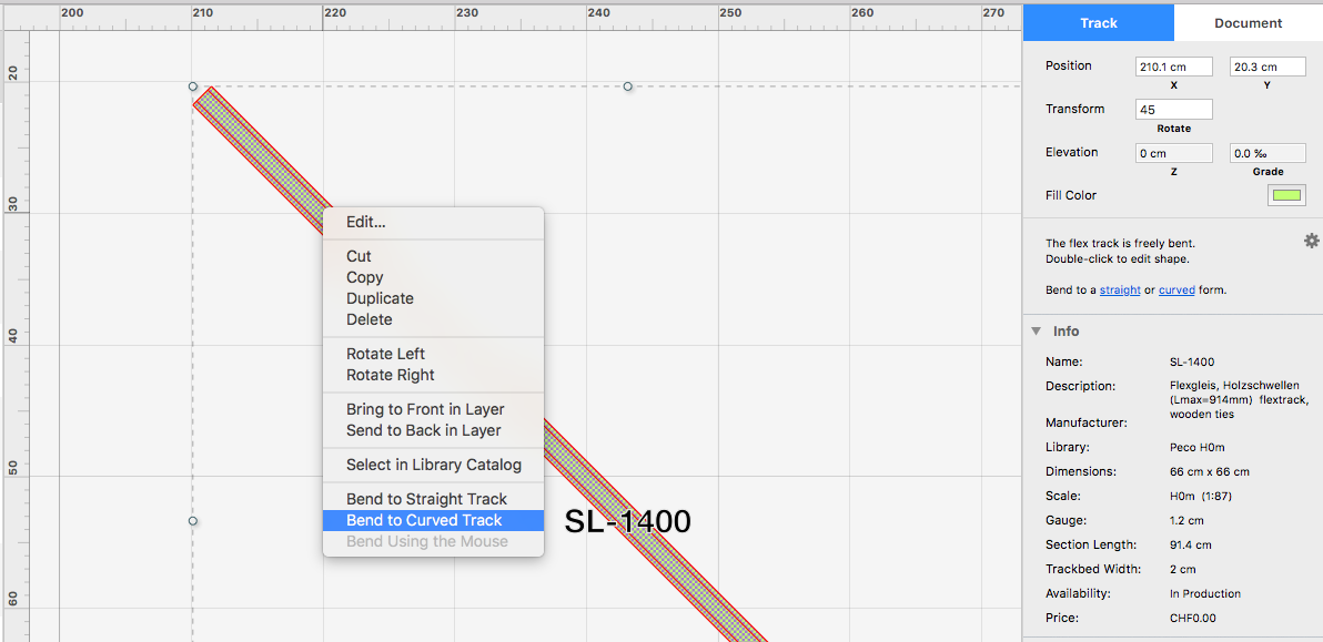

Flex tracks can be bent to a specific curved or straight track:
When the track is selected the flex track inspector in the sidebar to the right shows buttons to create a curved or straight flex track.
The same functionality is also available in the contextual menu for each flex track:

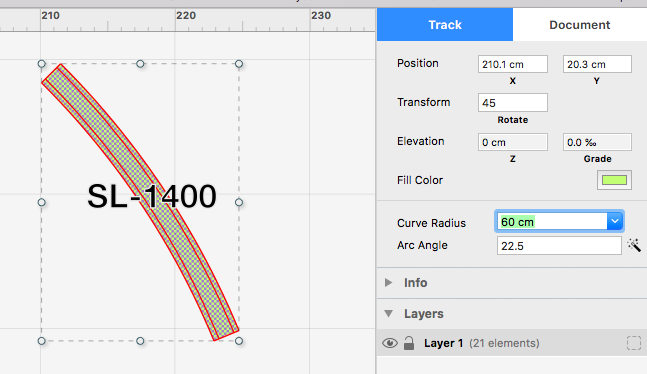

And once the track has been converted to a curved flex track parameters can be entered directly in the inspector:
The combo box offers presets with all radii used by the current track library - but any other radius can be entered as well.
Similar fields are offered when the track is bent to a straight flex track.
