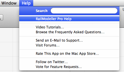

The manual can be found in the Help menu:

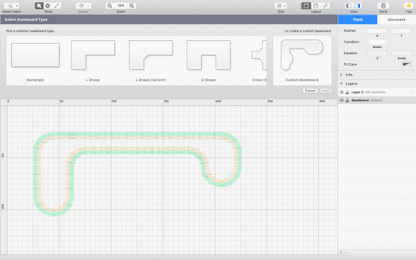

Just a quick heads-up that our latest update RailModeller Pro 5.3 introduces native support for baseboards.
The new baseboard assistant provides a quick way for getting started with commonly used layout shapes like L- or U-shapes:
Select a general shape, customize the dimensions to the desired values and start planning with just a few clicks.
We do of course support completely custom baseboard shapes as well for more specific requirements.
To get started simply use the new File > Add Baseboard command.

The custom baseboard function doesn't seem to work. It creates a rectangular board, 65x130 inches, which doesn't seem to be modifiable. The help file had nothing about baseboards when searched.
What am I missing? I purchased this because the custom baseboard promise seemed as if it would allow me to build to the non-standard space I have.
Posts: 616
Re: Baseboard size
the Using Baseboards section in the manual covers creating and editing baseboard.
Basically baseboards are manipulated with tools (like other elements in the app).
All the baseboard editing tools are available when selecting the baseboard layer.
The Baseboard Tools section linked from the baseboards section explains in more details what each of the tools can be used for, e.g. manipulating board position, individual corner points or borders, ..
Any specific questions please feel free to ask and we're happy to help!
