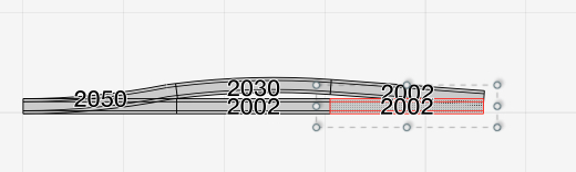

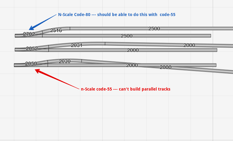

I've switched from AnyRail to RailModeller. In AnyRail, and according to Atlas, I should be able to use a 2030 (30.609" radius curve) with a 2050/2051 (#5 turnout) or a 2031 (71" curve) with a 2052/2053 (#7) to make a parallel track. However, in RailModeller this does not work as adding a 2030 to a 2050 does not reverse the turnout to allow say a flex track (2000) to be placed to provide parallel tracks at a 1¼" spacing. The addition of the 2030 is then not straight.
How have other people built parallel tracks cleanly with RailModeller?

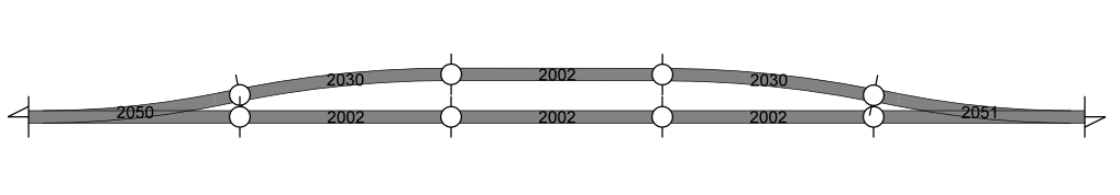

I did some follow up testing on this with Beta4 and Anyrail and even to be sure I went out and bought some #2030 track and RailModeller is definitely incorrect in the dimensions. Using a 2030 against a 2050 allows parallel tracks as per the images below.
Using RailModeller:
Rail Modeller.jpg (28.55 KiB) Viewed 7555 times
Using Anyrail:
Re: Atlas Code-55 and Parallel Tracks
Thanks for the info - I'll check the track definitions.
