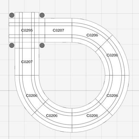

And proof that it's good in the now-available 6.2.5:
Screenshot 2020-02-15 at 20.04.51.jpg (49.68 KiB) Viewed 33299 times

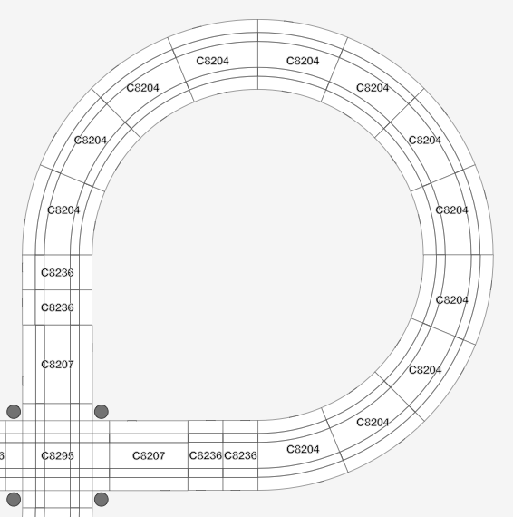

With R3 curves, the equivalent pattern is:
Screenshot 2020-02-16 at 23.11.11.png (74.36 KiB) Viewed 33288 times
Personally, I prefer "transition curves", where you lead in gently and get tighter, before leading out gently again. (e.g. R3 then R2 then back to R3). I still need to work out the pattern for that though!
