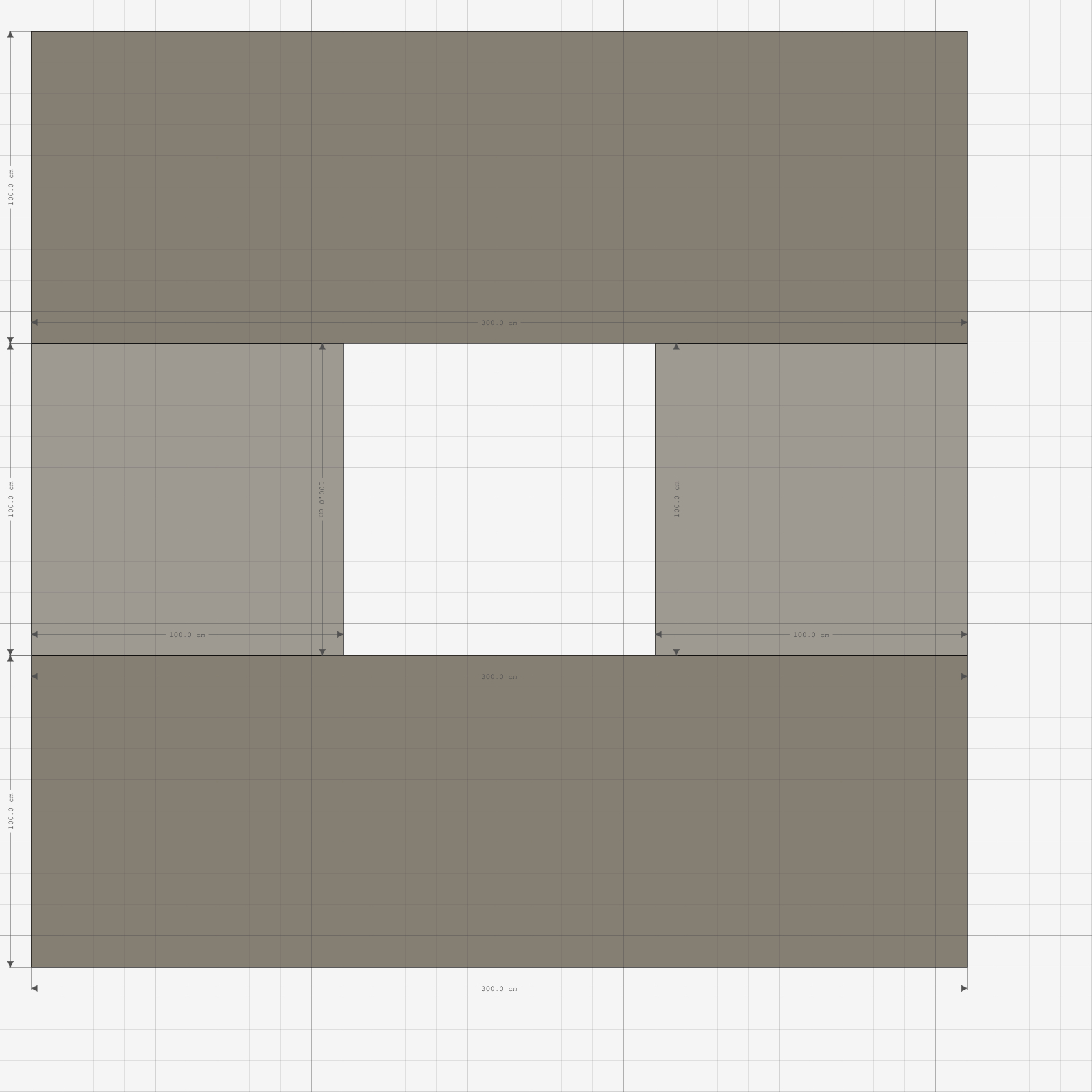

New to rail modeler pro and I am trying to build first layout with it. My benchwork is an "around the room" style with a area cut out of there middle to stand in. I have created a baseboard in the tool that represents my board without the hole in the middle. Im trying to figure out how to "cut out" the hole. Has anyone done this?

The easiest option would be to just use multiple, simple baseboards in order to build 'around' the hole.
Here's a simple example:
Baseboards around hole.jpg (409.72 KiB) Viewed 2733 times
