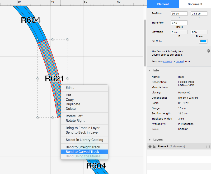

Firstly I create so much of a layout but don't like it all so want to grab certain parts and copy them into a new layout document. The only way so far is to duplicate the existing one make a copy and delete all the bits I don't want. This seems very long winded
Is there a better way please
Also copy section of track, I highlight all I want the copy and paste but only one section is produced?

I am planning in peace set track as I can't seem to master curve or gaps on sl100 within this programme. I spend hours trying and failing to lay a single curve in flex track..

In order to bend a flex track to a specific radius you can either
You can select the desired tracks you'd like to use in the new layout and invoke the Copy function from the Edit menu to copy them.
Then in the new layout you can use Paste from the Edit menu to insert just the selected tracks you've previously copied.
- Open the contextual menu (right click) on the track and select Bend to Curved, or
- Select the flex track and in the settings (gears icon) of the Flex Track inspector in the sidebar to the right select the Bend to Curved function.

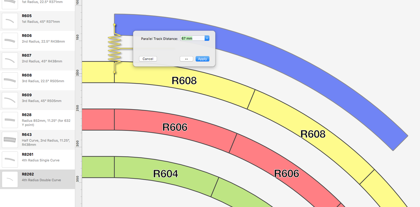

Is there a way of figuring out how close one can put tracks side by side working in sl 100.
Is there a preference that will not allow tracks to be placed too close together?

The assistants in the Smart Insert menu in the toolbar offer the Parallel Track function to insert the track currently selected in the Library Catalog at a specific distance (track center to track center) from a reference track in the layout:
In addition the measurement tool (shortcut R) can also be used to measure distances of tracks and other elements in the layout.
However, a dedicated overlap detection for tracks in the layout is not yet available.
