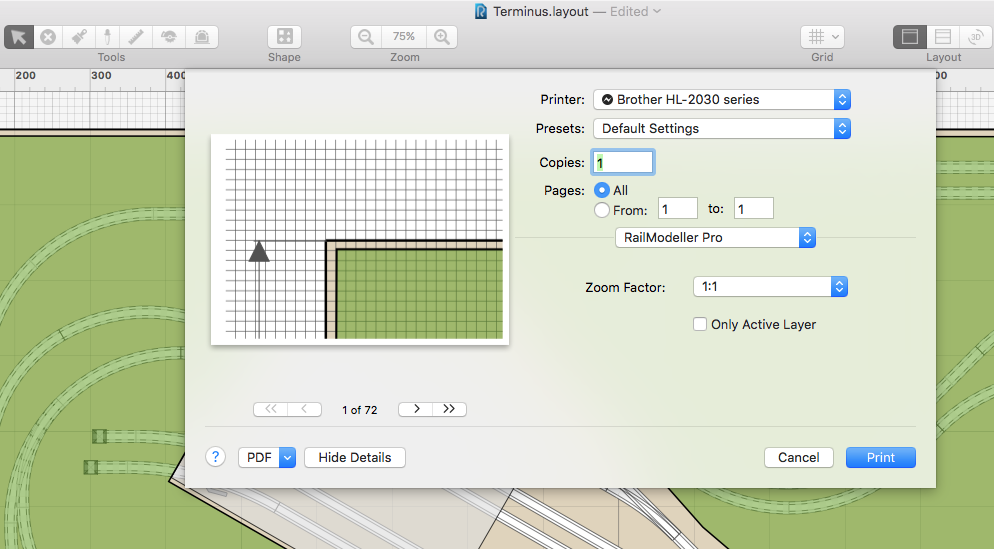

I could not find where in RailModeller pro one prints a full size track plan (i.e. for transfer to baseboards)? Can anybody please tell me how to do this?

The size of the printout can be adjusted in the Print Dialog by expanding the details for the RailModeller Pro section as shown in the screenshot below:
The 1:1 zoom factor will print in full size.
