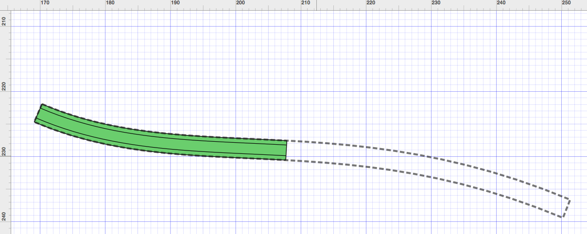

Quick update to this old thread:
The new Shorten Track tool in the latest update 5.2.3 also offers a great way to shorten flex tracks while keeping the overall shape:
shorten flex track.png (84.38 KiB) Viewed 21632 times
