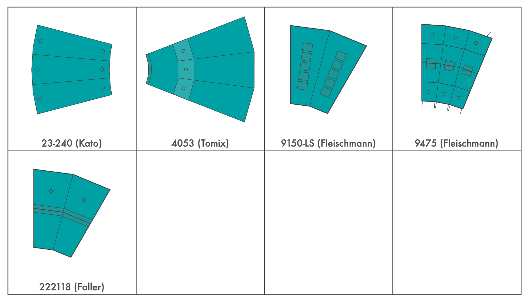

I am having a hard time to fit the allotted roundhouses with the Tomix fine scale track is there a away you can produce the Tomix roundhouse for Railmodeler Pro? Thanks!
Re: Working with roundhouse
Posted: 12 Dec 2019, 10:46
MoPac wrote: 10 Dec 2019, 13:28 roundhouses with the Tomix fine scale track
We've added the Tomix 4053 roundhouse to the 'Roundhouses N' accessories library for the upcoming 6.2 update!
Roundhouses N.png (161.47 KiB) Viewed 21524 times
